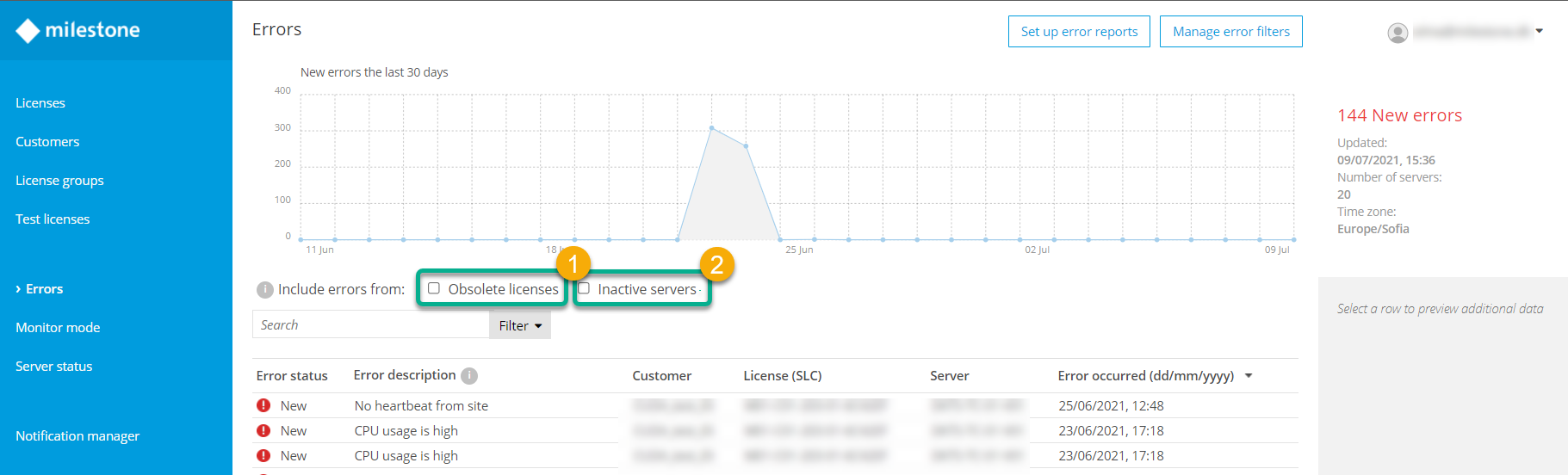

By default, only errors from active licenses with a heartbeat within the last 30 days are displayed. If you want to see more errors, you have the option to:
  • Include errors from upgraded licenses by selecting Obsolete licenses check box
  • Include errors from servers without a heartbeat within the last 30 days by selecting Inactive servers check box .

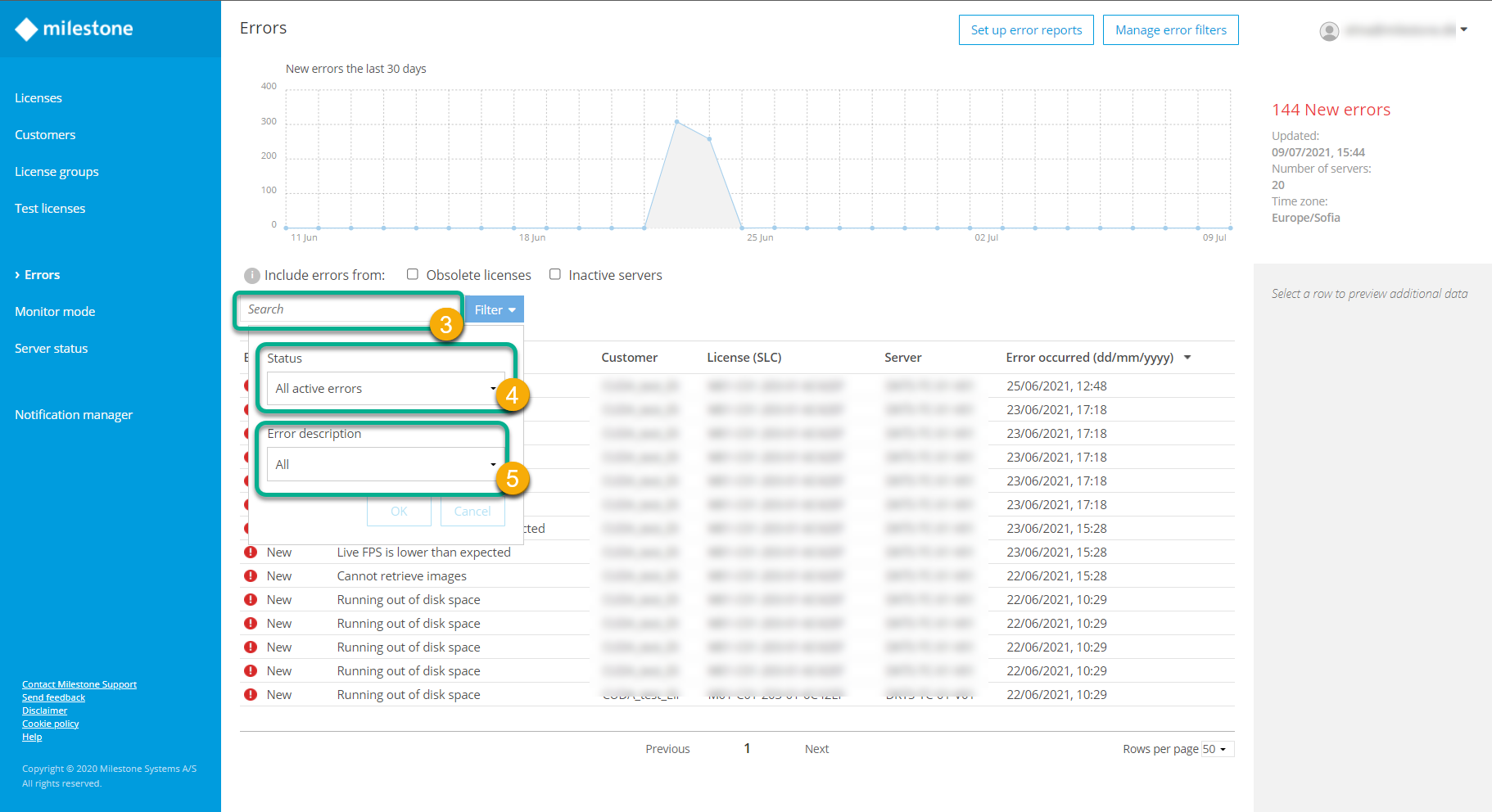

To look for specific errors:
  1. In Milestone Customer Dashboard, navigate to the Errors page.
  2. In the Search field, search for a specific license, customer, or server .
  3. (Optional) Use the Filter to search for a specific Status. You can select:
    • All active errors - Errors with status New and Being fixed that are not hidden by a custom filter
    • New - Errors that require attention
    • Being fixed - Errors that are currently under investigation
    • Filtered errors - Errors that are hidden from the main view by a custom filter
  4. (Optional) Use the Filter to search for a specific Error description. To see the complete list, go to Error descriptions (properties).
