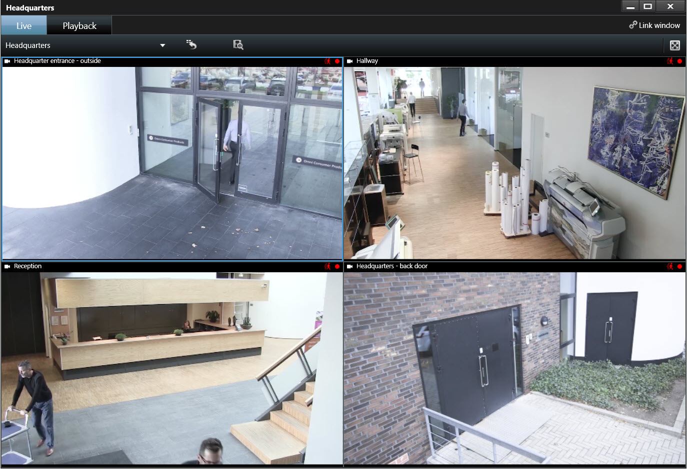

Multiple windows or displays (explained)
You can send individual views to separate windows or displays, while keeping the main window of the XProtect Smart Client in the background, so you can watch several views simultaneously. The selected camera or item is always displayed with a blue border.
You can send any view to:
                                    A primary display that shows the view in a separate full-screen window on the main display of your computer with the main window hiding behind it By default, the tabs and controls are hidden. Press ESC to make the tabs and certain controls reappear.
                                    A secondary display that shows the view in a full-screen window on another monitor (if available). The main window stays visible on the primary monitor By default, the tabs and controls are hidden. Press ESC to make the tabs and certain controls reappear.
                                    A floating window that shows the view in a separate window. You can open any number of floating windows and drag them to any monitor that is connected to your computer. Click Link window to synchronize the time in the floating window with the time of the main window.
Your multiple window setup is stored in XProtect Smart Client, so next time you log in, you can reuse it. However, the setup applies only to the computer that you are currently using. To use multiple windows on more than one computer, you must configure your multiple window setup on each computer.
