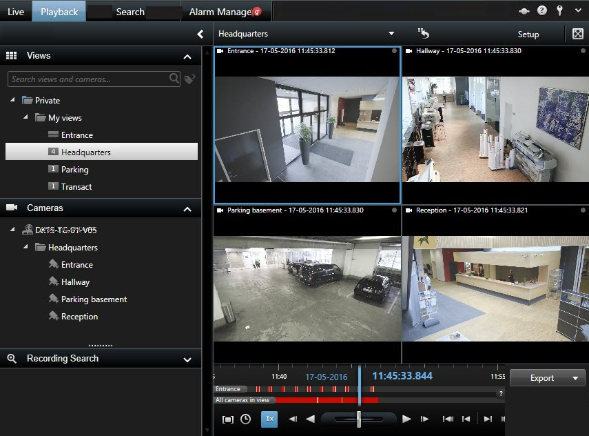

The timeline displays an overview of periods with recordings from all cameras displayed in your current view. Two timelines are displayed in the timeline area:
- The upper timeline shows the recording periods of the selected camera.
- The lower timeline is for all the cameras in the view, including the selected camera. If you have linked floating windows, these will also be included on the lower timeline.
You will see these colors in the timeline:
- Light-red indicates recordings
- Red indicates motion
- Light green indicates incoming audio
- Green indicates outgoing audio

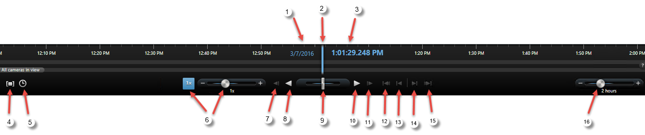

Time navigation controls (explained)
and
- The playback date and time is the time to which all the cameras are tied, except if you are in independent playback mode. When you play back recordings, all video in the view will be from the same time. Some cameras, however, may only record if motion is detected. Also, there may be no recorded video from one or more cameras in the view matching the specified point in time. Then, the last image in the database prior to the specified point in time will be dimmed.
- The Timeline time is indicated by a blue vertical line.
: Select a period of time by dragging the start and end time indicators on the timeline (typically when you are exporting video (see XProtect format settings). Click again to see the timeline with no time selected.
: Jump to a specific point in time by specifying the date and time.
- The playback speed slider lets you change the current playback speed. Move the slider to the left, for slow motion, and to the right for fast motion. Click 1x for normal speed.
: Move to the image just before the one currently viewed.
Play buttons
: Play backward in time.
Pause: When you click either Play backward in time or Play forward in time, the button turns into a pause button. This lets you pause playback without having to move your mouse pointer.
: Adjust the speed. Drag it to the right to increase forward play speed. Drag to the left to increase backward play speed.
Play forward in time.
Move to the image just after the one currently viewed.
Navigation buttons
Move to the first image in the database for the selected camera.
Move to the first image in the previous sequence.
Move to the first image in the following sequence.
Move to the last image in the database for the selected camera.
Specify the time span of playback in the timeline.

Viewing recorded video (explained)
You can view recorded video on the Playback tab, but also on the Search tab.
On the Playback tab, all cameras in a view display recordings from the same point in time, the master time . However, you can view and navigate recordings from individual cameras independently of the master time if this is enabled in the Functions settings. You can also use independent playback to view recorded video from the Live tab.

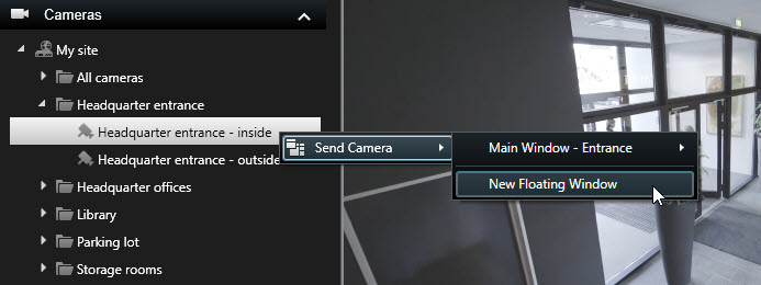

If you are accessing your cameras through the tree structure in the Cameras pane, you can open individual cameras in a new window on the Playback tab.
