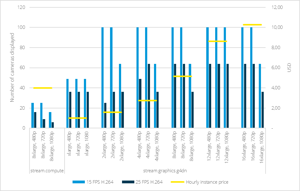

Milestone has done extensive testing of the Smart Client in AppStream, using different user scenarios, with different number of simultaneously displayed camera streams, different resolutions and at different frame rates. These tests are summarized in Figure 20 below. In the testing, Milestone has benchmarked the performance of decoding and rendering 480p, 720p and 1080p H.264 streams at 15 fps and 25 fps respectively.
The smallest instance size in the stream.graphics.g4dn family delivers remarkably good performance, and should be sufficient in most common usage scenarios. With reference to the table the stream.graphics.g4dn.xlarge instance supports decoding and rendering of approximately 49 camera streams at 15 FPS, or 35 streams at 25 FPS. If users view more cameras in a single view, the larger streaming instance types can be considered.
Figure 20. Amazon AppStream 2.0 – Smart Client performance at different user scenarios and different EC2 streaming instances measured on a HD display, and hourly instance price US East (N. Virginia)
