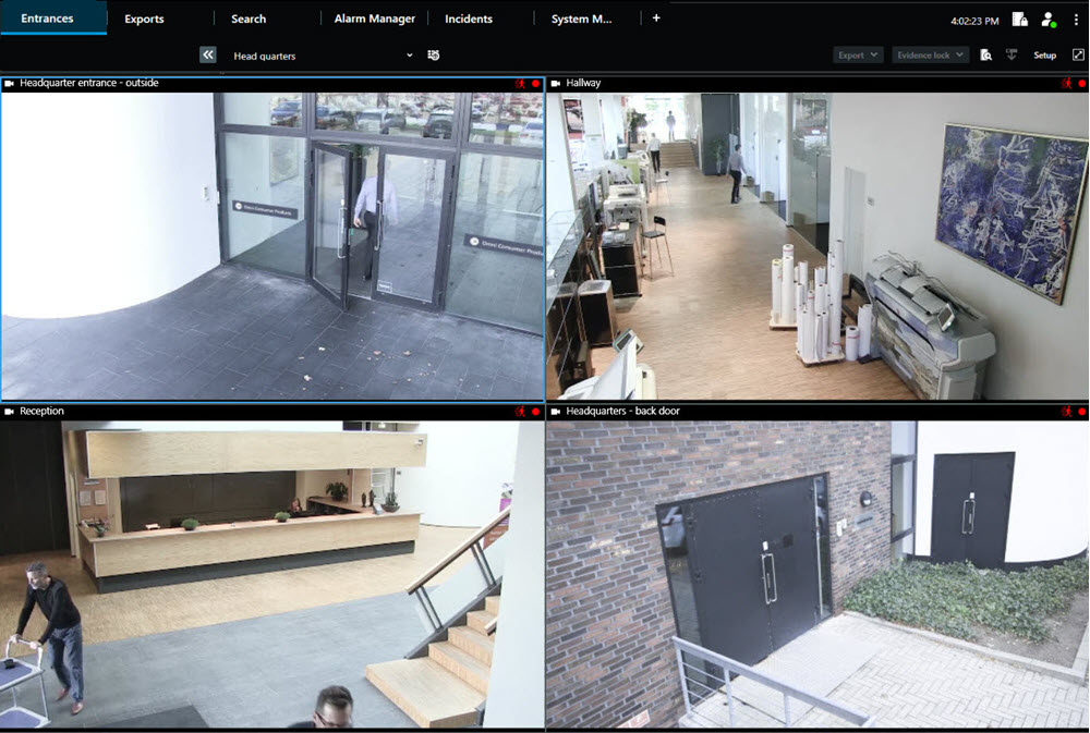

  • Display window (primary, secondary, and so on): A full-screen window where all tabs and controls are hidden. To close this window, move your mouse cursor to the top of the window and show hidden buttons such as the Close button.
    Example of a primary display in XProtect Smart Client.
