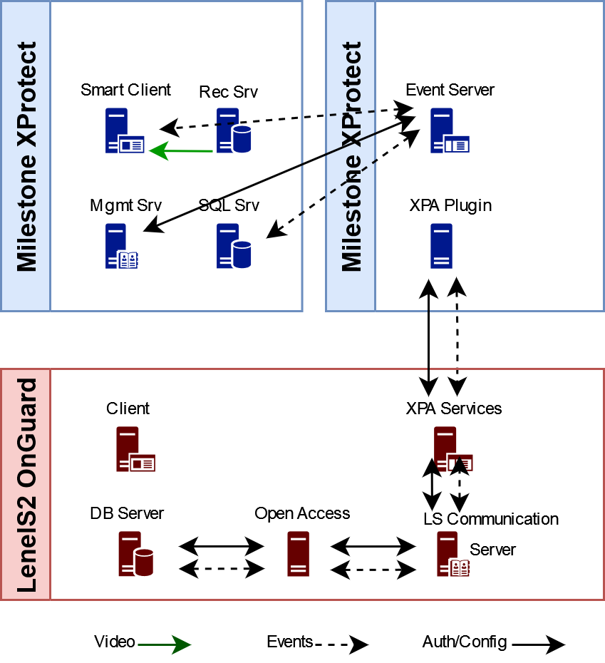

Below are the required system design details for integrating and configuring the system to support a distributed Event Server configuration. These include the system design diagrams and data flow, service account requirements, and firewall port requirements.
System architecture diagram for distributed Event Server:
The XProtect Access Plugin for XProtect should be installed on the Event Server. As in all other XProtect Access system design scenarios, the versions of the plugin on the XProtect system and the OnGuard system must match.
