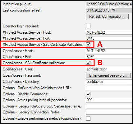

  7. Now apply encryption for the XProtect OnGuard Integration instance in the XProtect Management Client. This process enables use of OpenAccess- SSL Certificate Validation, option B below.
