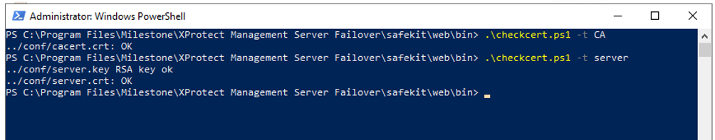

Install the server certificates
To make sure the failover web console knows which certificate to use, you must copy the certificate and its private key to the configuration folder:
  1. On Node 1, rename the server certificate to server.crt and the private key file to server.key.
  2. Copy the certificate and key files and paste them to C:\Program Files\Milestone\XProtect Management Server Failover\safekit\conf
  3. Repeat step 1 and 2 on Node 2.

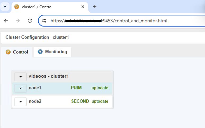

After you have completed these steps, try logging in to the failover web console.
If you are not able to log in to the console, verify that you have added the necessary exceptions to your Windows Firewall. See Ports used by XProtect Management Server Failover services and modules.
