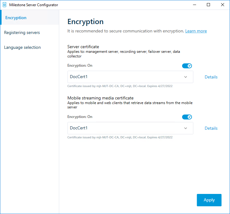

Server Configurator
Use the Server Configurator to choose the certificates that the XProtect servers use to secure communicates with their client applications, and to verify that encryption settings are configured properly.
In the Encryption section of the Server Configurator, set encryption of the following types:
Server certificate
Select the certificate to be used to encrypt the two-way connection between the management server and the following servers:
Recording Server
Event Server
Log Server
LPR Server
Mobile Server
Event server and add-ons
Select the certificate to be used to encrypt the two-way connection between the event server and the components that communicate with the event server, including the LPR Server.
Streaming media certificate
Select the certificate to be used to encrypt communication between the recording servers and all clients, servers, and integrations that retrieve data streams from the recording servers.
Mobile streaming media certificate
Select the certificate to be used to encrypt communication between the mobile server and the mobile and web clients that retrieve data streams from the mobile server.
In the Registering servers section of the Server Configurator, register the servers that are running on the computer with the designated management server.
To register the servers, verify the address of the management server and select Register.
