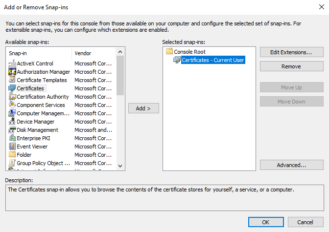

  1. On the computer that hosts the XProtect server, open the Microsoft Management Console.
  2. In the Microsoft Management Console, from the File menu select Add/Remove Snap-in….
  3. Select the Certificates snap-in and click Add.
    Click OK.
    Add the Certificates Snap-in object for the current user.
    Add or Remove Snap-ins

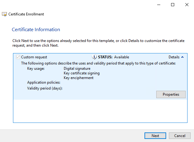

  7. Expand to view the Details of the custom request, and click Properties.
  8. On the General tab, fill in the Friendly name and Description fields with the domain name registered with the CA.

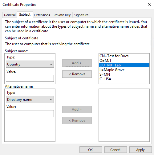

  9. On the Subject tab, enter the parameters as required by the specific CA.
    For example, the subject name Type and Value are different for each CA. One example is the following required information:
    • Common Name:
    • Organization:
    • Organizational Unit:
    • City/Locality:
    • State/Province:
    • Country/Region:

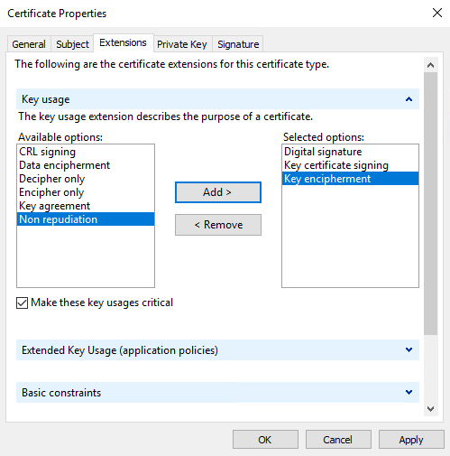

  10. Some CAs don't require extensions. However, if required, go to the Extensions tab and expand the Key usage menu. Add the required options from the list of Available options to the Selected options list.
    Key usage options in the Extension tab of the Certificate properties menu.
    Extension tab of the Certificate Properties for a CSR

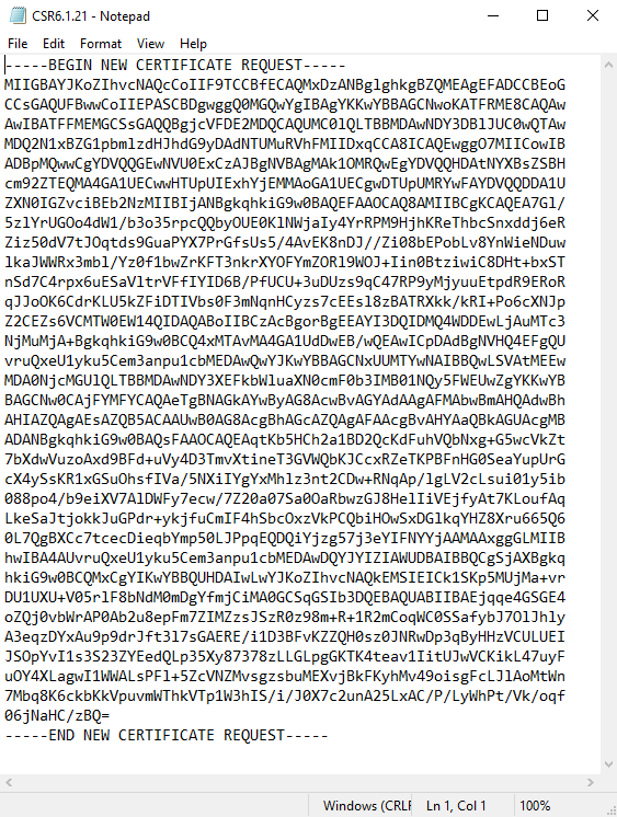

Your CA will need the contents of the .req file. You will be asked to copy the entire text of the .req file, including the begin and end lines, and paste the text into a field made available at a portal managed by the CA.
  1. Browse to the location of the .req file and open it in Notepad, and paste the text into a field made available at a portal managed by your CA.
    Copy the entire contents of the text file, including the begin and end statements.
    Text file contents of certificate request .REQ file.

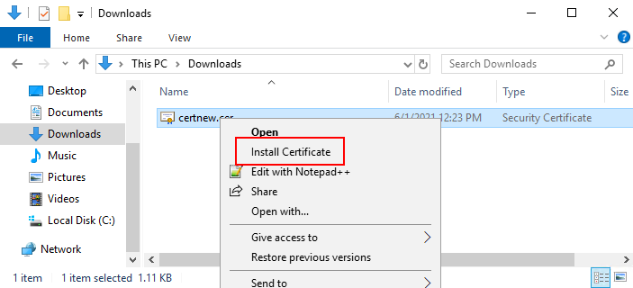

  2. When you receive the certificate from your CA, browse to the downloads folder (or wherever you choose to store the folder on the computer), right-click the certificate and select Install Certificate.
    Right click the certificate in the downloads folder and choose Install Certificate from the shortcut menu.
    Install the Certificate.

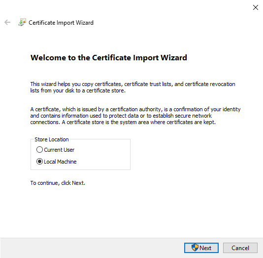

  3. Accept the security warning if it appears.
    Select to install the certificate for the local machine and click Next.
    Choose to install the certificate on the Local Machine store.
    Install the certificate on the Local Machine store.
