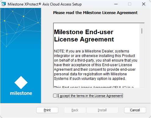

Download the installer from the Milestone Systems website. After starting it, read and accept the terms of usage and press Install.

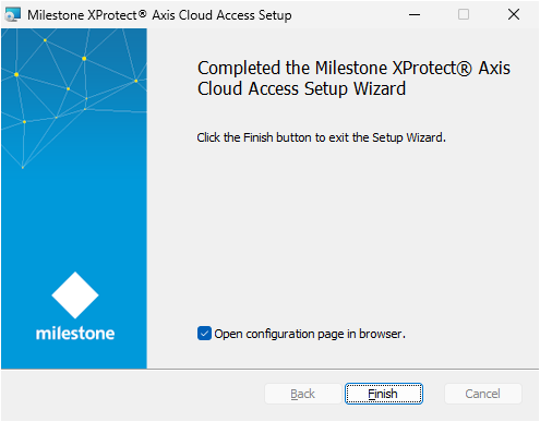

Upon finishing, select Open configuration page in browser to register or log in with an Axis account.

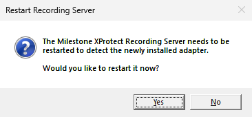

After successful installation, the XProtect Recording Server must be restarted for the Axis Cloud Connect driver to be available for selection. A message will appear offering to restart the Recording Server.
