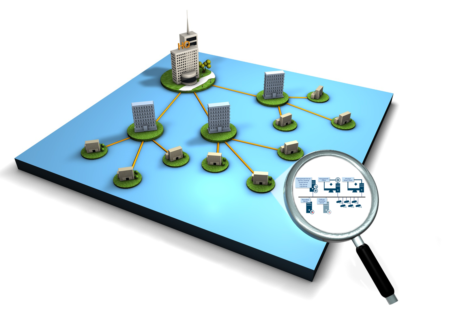

Corporation with regional and branch offices
A typical example for implementing Milestone Federated Architecture is a corporation with regional and branch offices as shown below.
Diagram Description automatically generated
In corporations with multiple offices, it is generally desirable for each installation to be tied into the overall corporate surveillance installation for central administration and monitoring, yet at the same time allow each branch office to have operational control over and access to their local surveillance installation.
With Milestone Federated Architecture, it is possible to log in, monitor and manage the distributed XProtect VMS systems centrally from both headquarters and regional offices, but also directly on each site. This is a key advantage in cases where a remote site for some reason is temporarily unable to communicate with the central headquarters’ XProtect VMS system.
