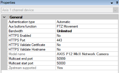

Axis drivers
Do the following:
  • Set HTTPS Enabled to Yes.
  • Set HTTPS Validate Certificate to Yes.
  • Set HTTPS Validate Hostname to Yes.

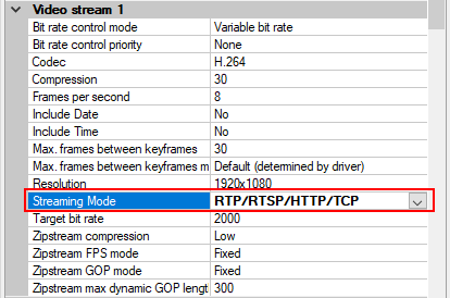

  • For every enabled media channel and media stream, set Streaming Mode to RTP/RTSP/HTTP/TCP.

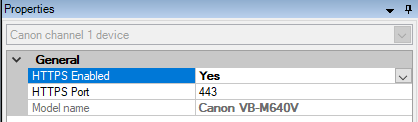

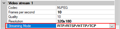

Canon drivers
  • Set the HTTPS Enabled to Yes.

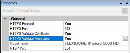

Bosch drivers
Do the following:

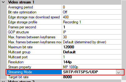

  • For every enabled media channel and media stream, set Streaming Mode to one of the following:
    • RTP/RTSP/HTTP/TCP
    • SRTP/RTSPS/UDP
    • SRT/RTSPS/UDP multicast

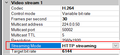

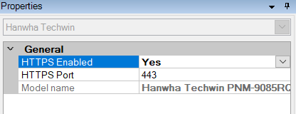

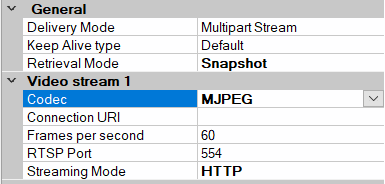

Hanwha drivers
  • For every enabled media channel and media stream, set Streaming Mode to HTTP streaming.

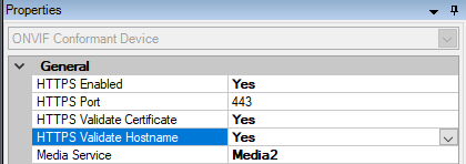

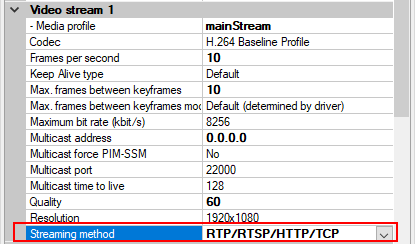

ONVIF drivers
Do the following:
  • For every enabled media channel and media stream, set Streaming method to RTP/RTSP/HTTP/TCP.

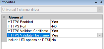

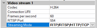

Universal drivers
Do the following:
  • For every enabled media channel and media stream, set Streaming Mode to either RTP/RTSP/HTTP/TCP or HTTP, depending whether streaming or snapshot retrieval mode is used.
