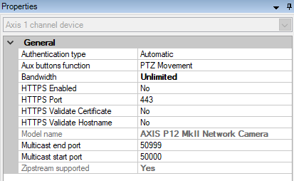

Axis drivers
Do the following:
Set HTTPS Enabled to Yes.
Set HTTPS Validate Certificate to Yes.
Set HTTPS Validate Hostname to Yes.
For every enabled media channel and media stream, set Streaming Mode to RTP/RTSP/HTTP/TCP.

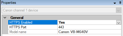

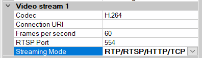

Canon drivers
Set the HTTPS Enabled to Yes.

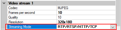

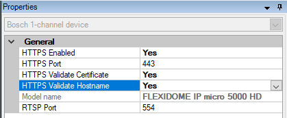

Bosch drivers
Do the following:

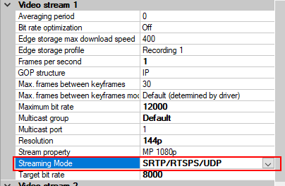

For every enabled media channel and media stream, set Streaming Mode to one of the following:
RTP/RTSP/HTTP/TCP
SRTP/RTSPS/UDP
SRT/RTSPS/UDP multicast

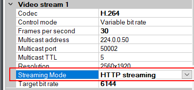

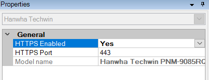

Hanwha drivers
For every enabled media channel and media stream, set Streaming Mode to HTTP streaming.

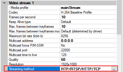

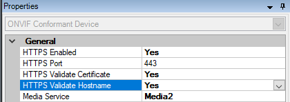

ONVIF drivers
Do the following:
For every enabled media channel and media stream, set Streaming method to RTP/RTSP/HTTP/TCP.
The Audio backchannel (Audio Out, Device Speaker) must not be used when the driver is running in FIPS 140-2 compliant mode.

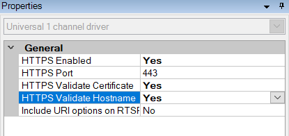

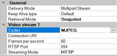

Universal drivers
Do the following:

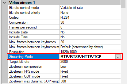

For every enabled media channel and media stream, set Streaming Mode to either RTP/RTSP/HTTP/TCP or HTTP, depending whether streaming or snapshot retrieval mode is used.
