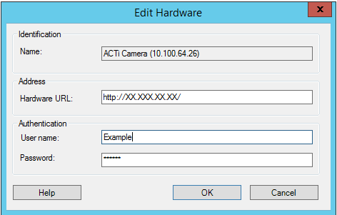

To change the user name and passwords of devices that are already added, follow these steps:
  1. In Management Client, in the Site Navigation pane, expand the Servers node and select Recording Servers.
  2. In the Recording Server pane, expand the recording server that contains the device, and then right-click the device and select Edit hardware.
  3. Under Authentication, enter the new user name and password.
