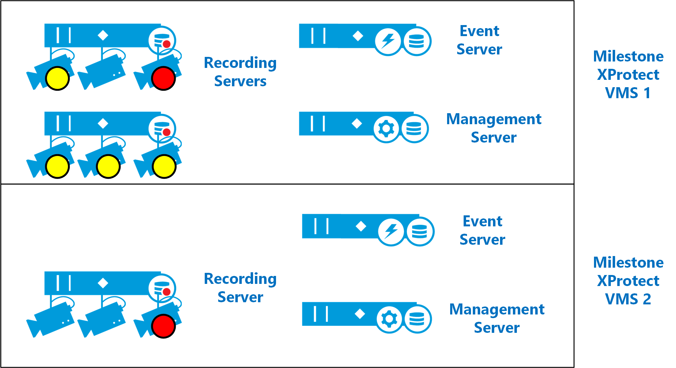

Example:
There are two XProtect VMS systems in the diagram below. Both integrated to the same CCure 9000 server. All nine cameras in this diagram would appear in the Available Cameras lists. To configure an event trigger that includes all cameras marked with yellow circles, it would take just one analytic event. However, to configure an event trigger that includes the two cameras marked with red circles, it would require two analytic events, one for each individual XProtect VMS system.
