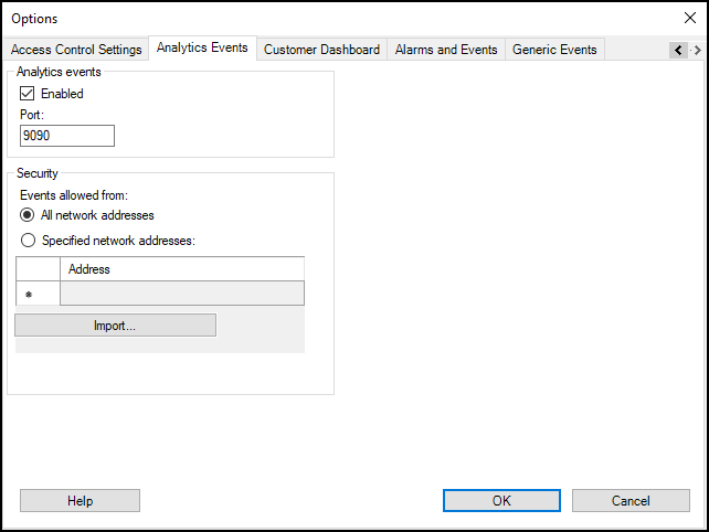

  1. In the XProtect Management Client, go to the Tools menu and select Options.
  2. In the Analytics Events tab of the Options window, select the Enabled option and verify the selection of port 9090 and All network addresses.

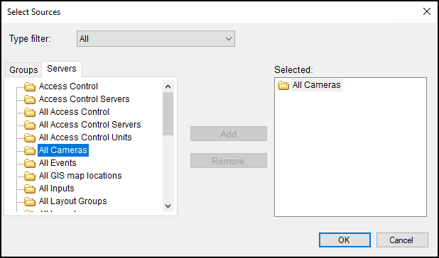

  6. In the Select Sources window on the Servers tab of the left-hand side, go to the All Cameras folder, then add the All Cameras folder as the selected source.
    Note
    The CCure Event Trigger includes each included camera’s FQID as the source. Because the included camera can change, using the All Cameras group ensures the event triggers.
