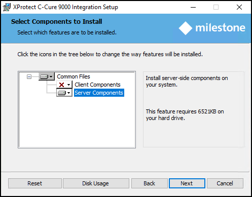

  2. Click Next to enter the component selection step. When you install on a CCure 9000 server that will not require the client components, open the Client Components list and select the Entire feature will be unavailable option.
  3. Open the Server Components list and select the Will be installed on local hard drive option.
