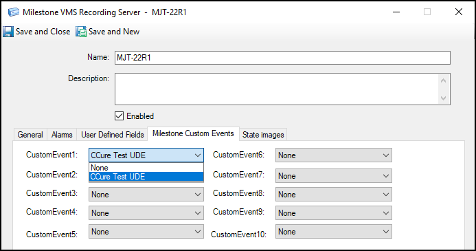

  1. Select the Milestone Custom Events tab from the configuration window of any recorder or camera.
  2. There are 10 custom event slots per recorder or camera. Each custom event number corresponds to the same Pulse Recorder/Device Custom Event number, which is available as an alarm on that recorder or camera.
  3. Open the CustomEvent list and select a user-defined event to trigger the custom event.

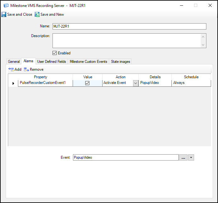

  4. Select the Alarms tab on the recorder or camera.
  5. Click the Add button.
  6. Open the Property list and select the Pulse Recorder/Device Custom Event with the matching number from the custom event above.
  7. Select the Value option to trigger the alarm in real-time.
