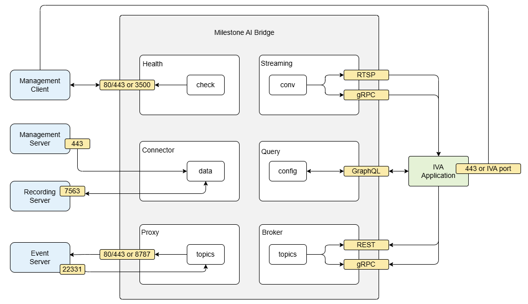

Ports used by the integration
Ports used by the XProtect VMS
Port number | Protocol | Owner | Purpose |
80 | SOAP | The Management Server service | Configuration. The purpose of port 80 and 443 is the same.
443 | SOAP | ||
22331 | SOAP | The Event Server service | Events. |
7563 | IS | The Recording Server service | Video. |
SOAP | The Recording Server service | Status API. |
Ports used by Milestone AI Bridge
The port numbers vary depending on whether the processing servers use Kubernetes or Docker Compose.
Docker Compose
3500 | REST | Milestone AI Bridge Health container | Health check of processing servers. |
8787 | VPS | Milestone AI Bridge Proxy container | Video and metadata. |
Kubernetes
80 | SOAP and API Rest | nginx-gateway-controller | Health check of processing servers. Video and metadata. The purpose of port 80 and port 443 is the same.
443 | SOAP and API Rest |
Ports used by the IVA applications
When an IVA application registers itself on Milestone AI Bridge, the IVA application often also provides an URL to web page displayed in XProtect Management Client. For information on which other ports are used by an IVA application to communicate with Milestone AI Bridge, consult the documentation for the IVA application.
Individual for each IVA application | HTTP or HTTPS | IVA application | Web page made available in XProtect Management Client where you can draw the graphical representation of the selected analytics topic on top of the video from the camera. Requires Microsoft Edge WebView2. See Subscribe for video analytics and receive analytics data back. |
