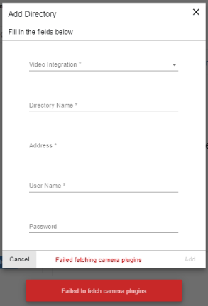

Failed fetching camera plugins error
Symptom
In the Camera management section of the BriefCam Administrator Console when trying to add a directory, the Milestone Integration option is not available and the Failed fetching camera plugins error appears at the bottom of the screen.
Possible root causes

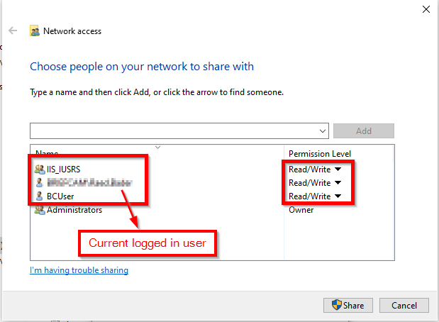

  4. Check the Data folder for sufficient permissions. The current logged in user should have read/write permissions.

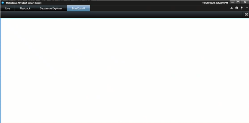

White screen displayed
Symptom
XProtect Rapid REVIEW was installed without any errors. However, the embedded client shows a white/blank screen.

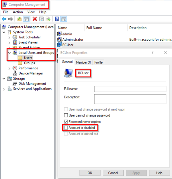

Note that by default the user who runs the BriefCam services is the BCUser. You may still see the white screen issue if the user configured as BCUser was disabled, for example, after moving to a domain. To solve this issue:
    • From the Windows Services, try restarting the BriefCam VSService.
    • If the service fails to start, then check the BCUser settings in the Computer Management console.

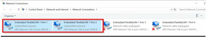

The white screen might display if either the BriefCam server of Milestone smart client computer has two NICs (network interfaces) are attached to it and the SSO communication looks for the local host.
As a result, there are issues loading BriefCam’s iFrame in the Milestone embedded client.
  1. Check how many activated NICs exist, by going to Control Panel > Network and Sharing Center > Change adapter settings.
  1. If there is more than one NIC activated, if possible, inactivate one of the NICs.

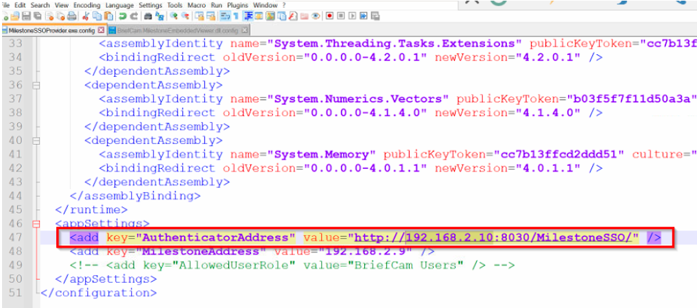

If the above did not resolve the issue, you need to change the value in several locations so that it does not point to localhost but rather to the BriefCam server’s IP address (the IP address of the NIC configured to communicate between the BriefCam server and the Milestone server):
  1. On the BriefCam server, open the Milestone SSOProvider.exe.config file (located by default at: C:\Program Files\BriefCam\BriefCam Server) and find the AuthenticatorAddress value.
  2. If the value is set to localhost, change the value to point to the BriefCam server’s IP address.
By default the MilestoneSSOProvider.log file is located at C:\Program Files\BriefCam\BriefCam Server\logs\MilestoneSSOProvider-0.

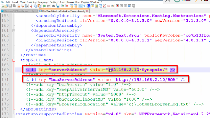

  1. On the Milestone XProtect Smart Client computer, open the BriefCam.MilestoneEmbeddedViewer.dll.config file (located at: C:\Program Files\Milestone\XProtect Smart Client\MIPPlugins\BriefCam).
  2. If the value of the serverAddress or boaServerAddress key is set to localhost, change the values to point to the BriefCam server’s IP address.

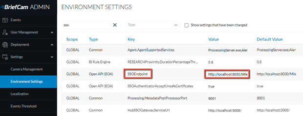

  3. In the BriefCam Administrator Console, go to Settings > Environment settings and search for the SSOEndpoint setting. If the value is set to localhost, change it to the BriefCam server’s IP address, that is: http://[ BriefCam server IP address ]:8030/Milestone.

  1. In the BriefCam Administrator Console, go to SettingsEnvironment settings and search for the SSOEndpoint setting. If the value is set to localhost, change it to the BriefCam server’s IP address, that is: http://[ BriefCam server IP address ]:8030/Milestone.
  1. Open the MilestoneSSOProvider.exe.config file (located at: C:\Program Files\BriefCam\BriefCam Server) and find the AuthenticatorAddress value.
  2. If the value is set to localhost, change the value to the BriefCam server. If there are multiple NICs, this should point to the BriefCam server.
  3. In the BriefCam.MilestoneEmbeddedViewer.dll.config file (located at: C:\Program Files\Milestone\XProtect Smart Client\MIPPlugins\BriefCam), both the serverAddress and the boaServer address need to point to the BriefCam server. If there is more than one NIC, use the IP address of the BriefCam server. Below are detailed instructions of how to do this:
    1. Scroll to the bottom of the file and look for the following lines: <add key=”serverAddress” value=”http://computer’s_hostname/synopsis/” />
    2. Change the values to match your BriefCam server (the XPRR Computer). For example, if the BriefCam XPRR computer is called RapRev, the value will look as follows: http://RapRev/synopsis/
    3. Find this row: <add key=”boaServerAddress” value=”http://cmputer’s_hostname/BOA/” />
    4. Change the value point to your Milestone server. For example: http://RapRev/BOA/

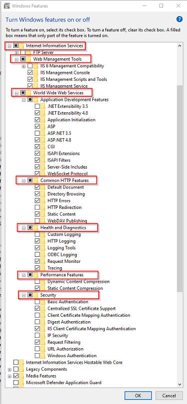

  1. From the Windows Control Panel, open Programs and Features.
  1. Click Turn Windows features on or off.
  2. From the list, make sure that all the Internet Information Services that appear in the illustration below are available.
    • If any of the below is missing, add it.
    • Restart the computer.
