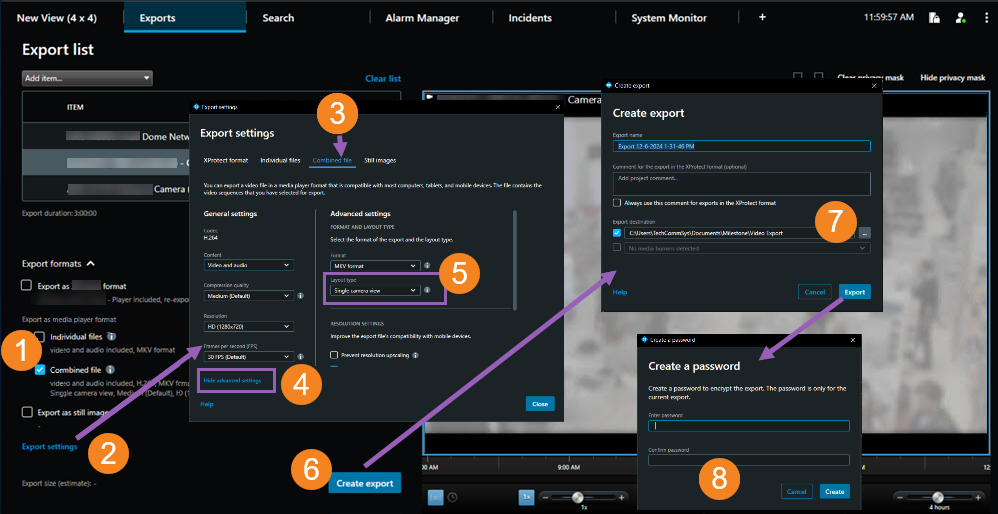

The following steps are the last steps you need to complete to export video. At this point, you have already added video sequences to the export list and perfected the content for export.
You can export several video or audio sequences from various cameras combined into one file in media player format.
Choosing this format has the benefit that the recipient doesn’t need to know how to use XProtect. Most media players can also play the exported files. You only need to have a media player installed to play exported files in this format.
Steps | Action |
Select the export format. |
Change or verify the format settings. |
Choose what you want to export and the quality of the export. |
Select Show advanced settings if you want to change the layout of the export, improve compatibility with mobile devices and media players, and include timestamps and camera names. |
Select Single camera view to play only one video at a time according to the order you have arranged the cameras in the export list. Select Adaptive view, to play back the video in the order it was recorded. If video sequences were recorded at the same time, they are also played back at the same time. |
Start the export. |
Give the export a name, add a comment, and choose where to save the export file. Select Export. |
If you have chosen to protect the export file with a password, now enter a password and select Create. |
