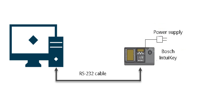

All communication between the Bosch IntuiKey Keyboard and the third-party PC is performed through an RS-232 interface. The following diagram illustrates this configuration:
This connection requires a standard Null modem RS-232 cable. Connect one end of the RS-232 interface cable to the 9-pin RS-232 Serial Port located on the far right side of the rear of the Bosch IntuiKey Keyboard. Connect the other end of the RS-232 interface cable to a COM port on the PC.
If the computer does not have an RS-232 interface, do one of the following:
  • If you computer has a USB port, connect the Null modem RS-232 cable to a USB-to-RS232 converter
  • To add a COM port, install a PC card
To use Terminal mode, the firmware version on the Bosch IntuiKey Keyboard must be 1.92 or later.

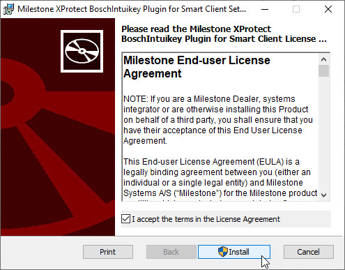

The XProtect Input Unit Plug-in for the Bosch IntuiKey Keyboard comes with an installer. To install the plugin, do the following:
  1. To download the installer for the XProtect Input Unit Plug-in, go to https://www.milestonesys.com/download/ and download the appropriate installer for your computer.
  2. Double-click Milestone_BoschIntuikey_Plugin_Installer.msi to start the installation.
  3. To install the XProtect Input Unit Plug-in, accept the terms of the license agreement and then click Install.
  4. When the installation is complete, click Finish.
