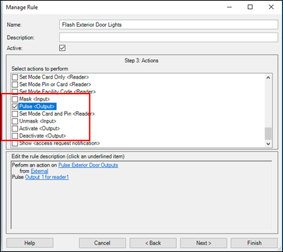

Reader Inputs:
  • Mask
  • Unmask
Reader Outputs:
  • Activate
  • Deactivate
  • Pulse
Reader inputs have a state of masked or unmasked. A masked input doesn't report or save status in the OnGuard system. The masked input also has a "mask" icon attached to its own icon on the Smart Client map. Unmask enables status of that input to be reported and saved within OnGuard, and removes the mask icon. Reader outputs are activated, de-activated, and pulsed using the respective commands. The Pulse command activates the output temporarily, then deactivates it. An activated output has a red circle icon attached to it when viewed on the Smart Client map.

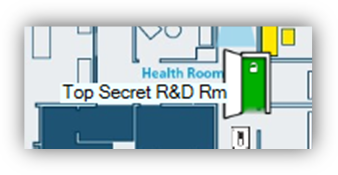

Doors:
  • Open
Doors are opened via the command. When the door opens, the door icon animation displays this status on the Smart Client map.
