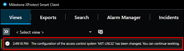

After the global configuration updates, all open Smart Clients using a personalized configuration display the following info message.
Log out of the Smart Client and log back in using the personalized configuration to load the updated configuration.

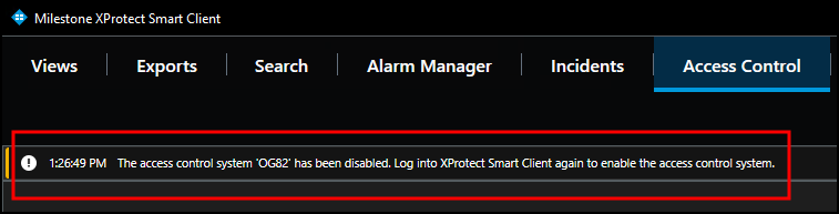

The following error message that the system has been disabled can result from a modified OnGuard segment configuration for the current logged in operator.
Log out of the Smart Client and log back in to restore integrated access control system functionality.
