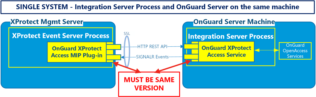

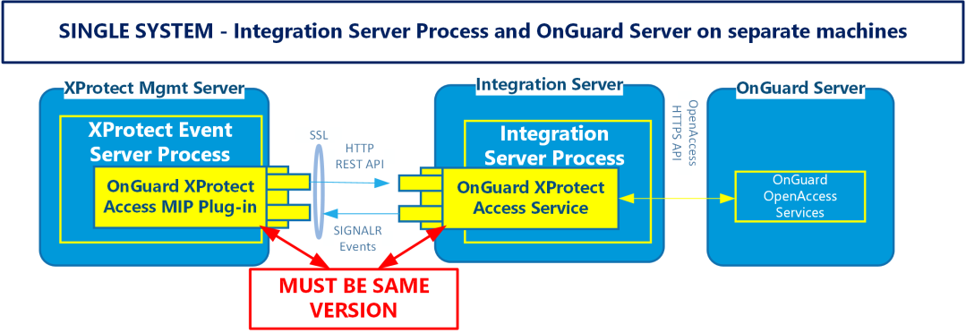

  1. OnGuard XProtect Access Service - Installed on the OnGuard Server machine, or its own integration server.
  2. OnGuard XProtect Access MipPlugin - Installed on the XProtect Event Server machine, or on a standalone Milestone XProtect Management Server.
OR
It's required that the exact same versions of the OnGuard XProtect Access integration software components are installed on both the XProtect and OnGuard machines.
