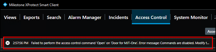

If commands are turned off, none of the command features work, however it's still possible to view command buttons in the Smart Client and create rules in XProtect which use commands. These rules validate, and the buttons appear, but nothing happens. In the Smart Client users receive the following error message:
HH:MM:SS AM/PM Failed to perform the access control command ‘**COMMAND**’ on ‘**DEVICE**’. Error Message: Commands are disabled. Modify the plugin configuration in the XProtect Management Client to enable commands.
