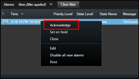

Acknowledging an alarm in XProtect changes the alarm state to in progress both in XProtect and in OnGuard.
