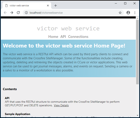

  1. If the browser opens a page similar to the one below, everything is okay with the victor web service

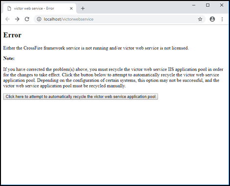

  1. If the browser leads to an error message similar to the one seen below, click the button shown on the page to recycle the victor web service application pool
