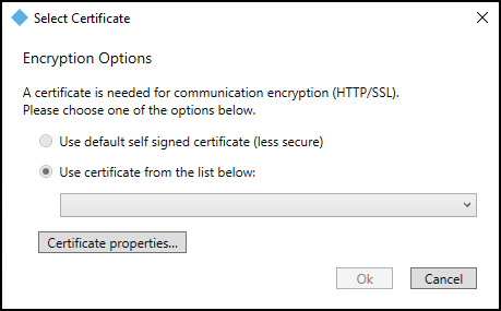

After installing the XProtect Access service on the CCure 9000 server there may be no certificates available in the Select Certificates window. This topic explains why this can happen, and how to fix it.
  1. If there are no options available to select, or simply no valid certificates for use, you may notice because both the default and third party options are unable to be selected.

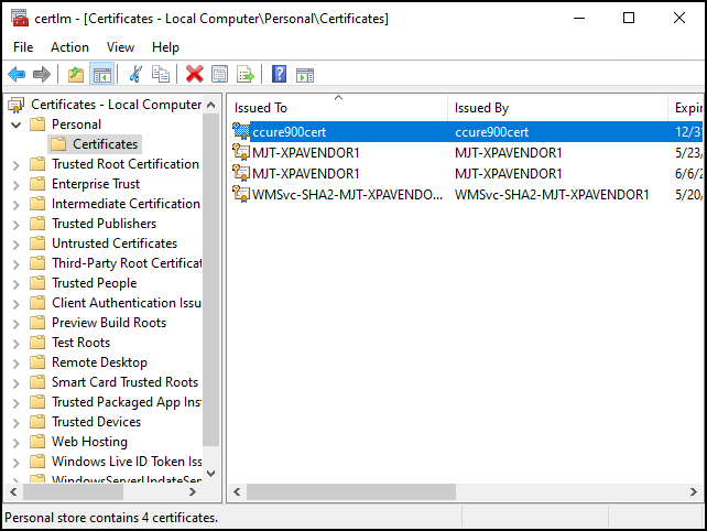

  1. It is possible that the default certificate, and any third party certificates, were removed or misplaced from the local personal certificate store. Check the local personal certificate store for certificates.
  1. Run the certlm.msc command, expand the Personal folder and select the Certificates folder to view all available certificates.
