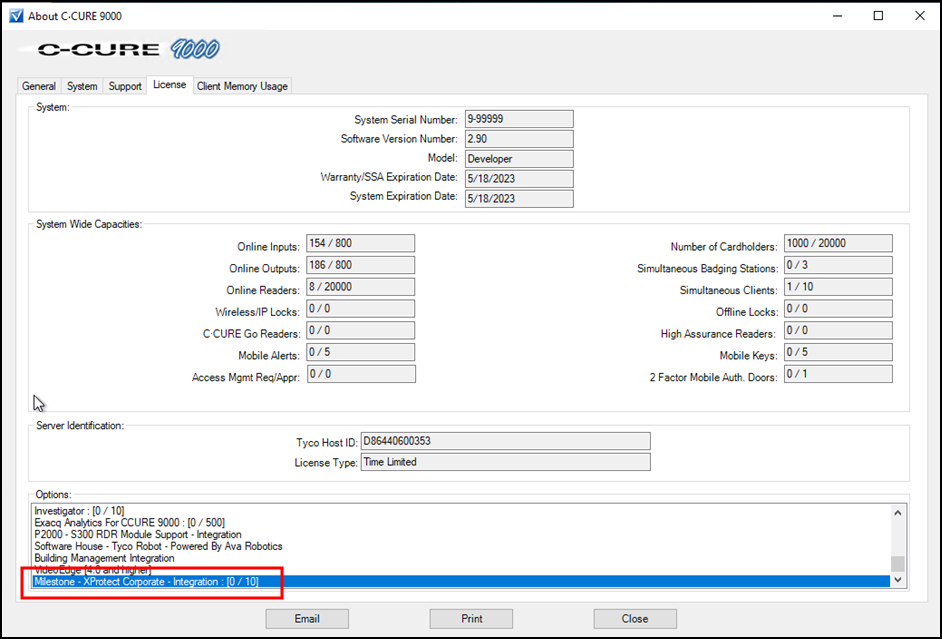

CCure 9000 web service API license
In CCure 9000 version 3.00.1 or higher the license requirements change. The only required license is:
                                    Milestone - XProtect Corporate - Integration
This is a web service API license, therefore it includes the victor web service component.
The license must display the available concurrent connections for the web service. [0/10]
