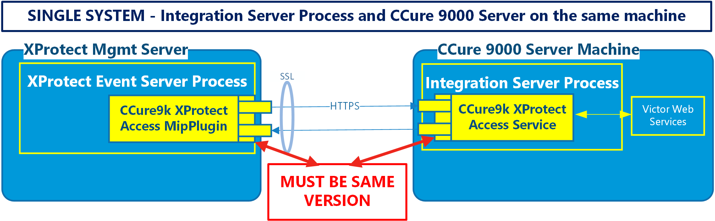

Solution overview
The integration software download is a single context sensitive installation program. This program name is:
XProtectAccess.CCure9k.msi
When this program runs it identifies the software installed on the local server, CCure 9000 or XProtect, and it helps install the required software. One of these two options are presented:
  1. The CCure XProtect Access Service that runs on the CCure 9000 server.
  2. The CCure XProtect Access MipPlugin that runs on the XProtect server.
