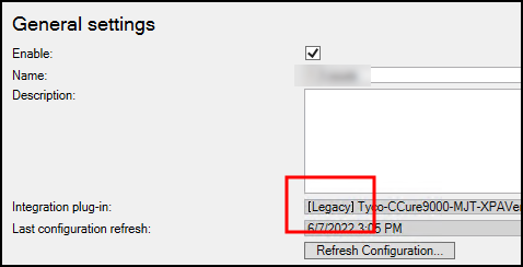

After upgrading the integration, any previous versions of the XProtect Access instance in the XProtect Management Client will have the [Legacy] label added to it. This simply identifies an upgraded XProtect Access instance.

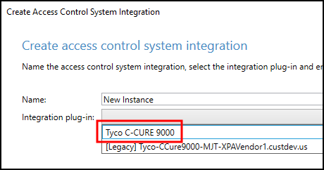

Any new XProtect Access instances which are added to the same XProtect system have the option to choose between the new version and the [Legacy] version during the instance creation wizard. New instances should always choose the version which is labled:
  • Tyco C-CURE 9000
