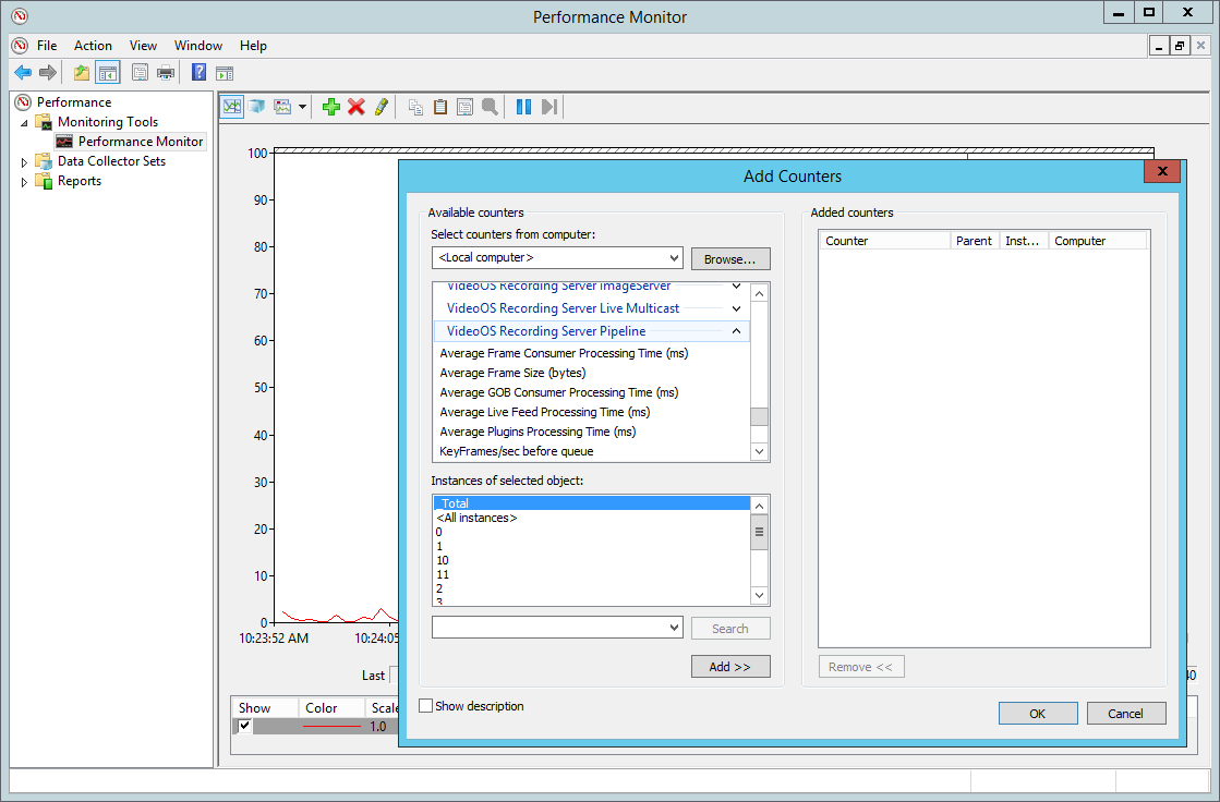

Windows reliability and Performance Monitor
Performance Monitor is a powerful tool that is built into Windows. It can be used to track various Windows counters over time, such as CPU, network, disk load and I/O. In addition to the standard Windows counters, it can monitor counters from other software services if they offer service-specific counters.
The XProtect VMS products support a wide range of VMS-specific performance counters that can be used in the Performance Monitor to monitor the VMS’ performance and pinpoint issues or bottlenecks within the VMS or its use of the server hardware.
The Performance Monitor can be started by typing “perfmon” in Windows start menu.
