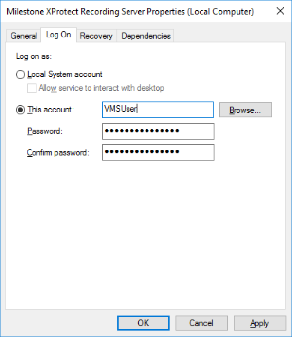

When enabling security on a NAS/file share, the recording server service must be changed from running under the ‘Network Service' account to running under a Windows Domain or Workgroup account. The account the recording server service is set to run under must then be granted rights to access the NAS/file share holding the media database.
The account to run the recording server service under is set via the Microsoft Windows ‘Services’ dialog.

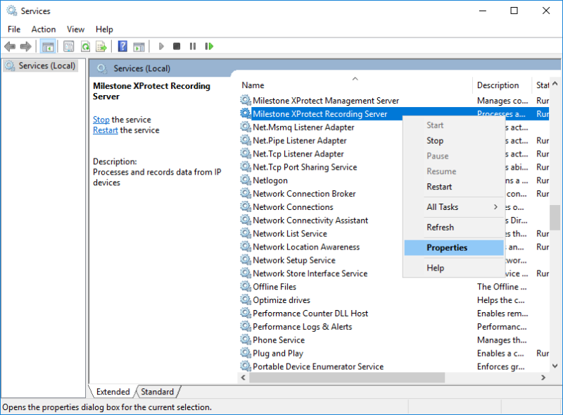

Open the ‘Services‘ dialog in Microsoft Windows, find the ‘Milestone XProtect Recording Server‘ service in the list. Right-click and select the ‘Properties’ option. In the shown dialog, select ‘Log On’, then ‘This account:’ and enter user credentials for a user with access to the file share.
