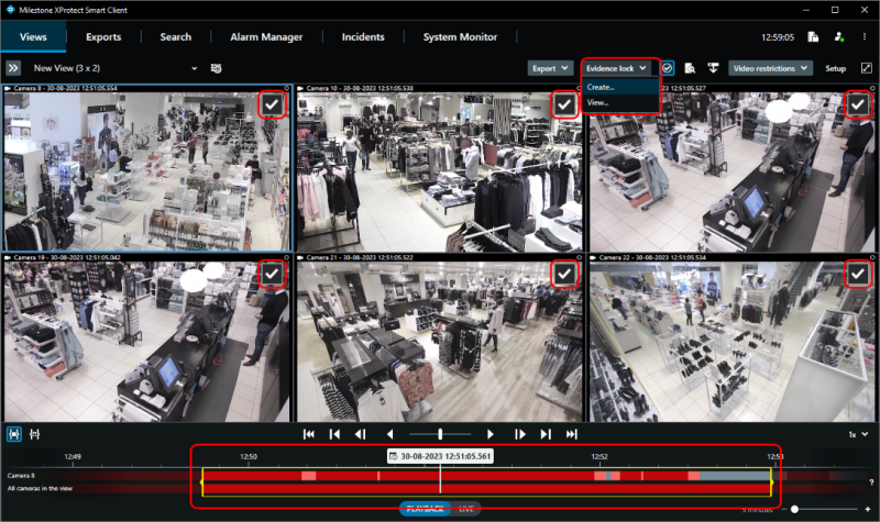

Evidence locks are created using the XProtect Smart Client. To create an evidence lock, select ‘Playback’ and select a time period to lock via the timeline, or enter the start/stop time manually, and then select the cameras in the view to include. Finally, click the ‘Evidence Lock’ control and select ’Create’.

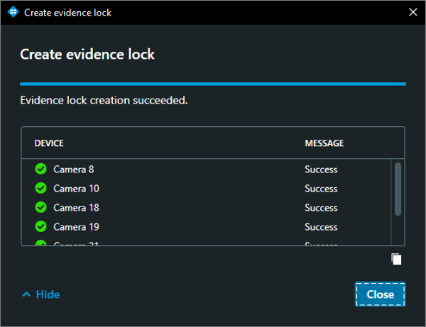

Once the evidence lock has been created, a status dialog is displayed showing which devices are included in the evidence and if the action has been successful.

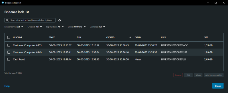

The list of evidence locks in the system can be found by clicking the ‘Evidence lock list’ button in the XProtect Smart Client’s main window.
When an Evidence Lock is selected in the list, it is possible to directly play back or export the recordings. Furthermore, if the user has the security permissions for it, it is possible to edit parameters of the evidence lock and add or remove devices from the evidence lock
Finally, if the user has the security permissions for it, the evidence lock can be deleted. Deleting an evidence lock does not necessarily mean that the recordings are also deleted as this depends on whether the locked recordings are younger or older than the standard retention time set for the storage configuration on the recording server. If the locked recordings are older than the set retention time, the recordings will also be deleted when deleting the evidence lock.

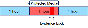

To avoid tampering with possibly encrypted and signed media databases, as well as for performance reasons, an evidence lock will always lock and protect at least a single one-hour segment of the media database for each device – no matter how small the time span of the actual evidence lock may be.
If the selected time span for the evidence lock spans multiple one-hour segments in the media database, all segments it spans are locked and protected.
This means that every single evidence lock will protect more recordings than just the selected time span. For short sequences, like for instance an evidence lock covering a few minutes, this overhead may be quite large in terms of percentage. For longer sequences, like for instance an evidence lock spanning 24 hours, the overhead percentage will be much smaller.
