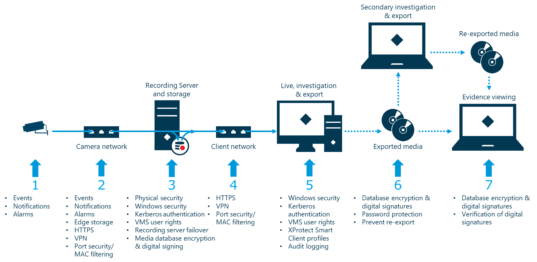

Addressing security concerns and risks
As highlighted, there are several places where security and integrity can be breached. In addition to applying standard physical and IT security practices, Milestone has implemented several security functions in the XProtect VMS to further increase security and reduce risks, threats, and concerns. The illustration below shows a selection of security measures that can be used to counter tampering, manipulation, and unauthorized access in each step of the media flow.

Media is captured by the camera
Risk
Camera may be tampered with by moving it or covering the lens.
Mitigation
Most cameras can send events to the VMS when detecting different kinds of tampering, for example: moving the camera, covering the lens or in other ways obstructing the video. Once this is detected a camera event is triggered, which can be used to trigger alarms or send notifications via SNMP Traps, emails, or via 3rd party integrations.
Alternatively, if the camera does not support detecting tampering natively, 3rd party solutions that offer this can be found on the Milestone Marketplace:

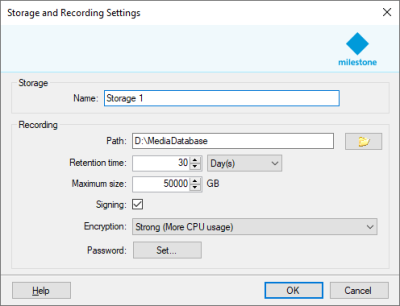

Configuration
Configuration of the media database is done in the Management Client per recording server. Enabling encryption and digital signing is a simple matter of opening the storage configuration, and:
  • Check the ‘Signing’ check box
  • Select ‘Light (Less CPU usage)’ or ‘Strong (More CPU usage)’ in the ‘Encryption:’ drop down menu
  • Enter a media database password

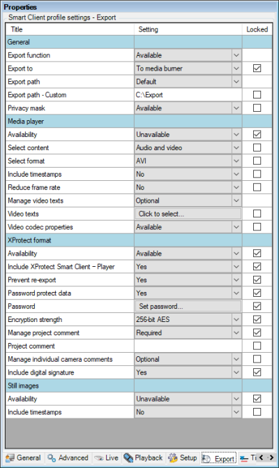

To further control how exported media are handled, the VMS - in extension to security permissions - supports ‘Smart Client Profiles’ which control how the XProtect Smart Client behaves and what features or functions are available for the user – including what export formats and functions are available to the VMS user with export permissions.
To ensure maximum security of the exported media, and to prohibit unauthorized distribution and viewing of the exported media, it is recommended to set the Smart Client Profiles export settings to the following:
  • Export toàTo media burner
  • Media playeràUnavailable
  • Still imagesàUnavailable
  • XProtect formatàAvailable
  • Include XProtect Smart Client – PlayeràYes
  • Prevent re-exportàYes
  • Password protect dataàYes
  • Passwordàset to a predefined password
  • Encryption strength’ à256-bit AES
  • Manage project commentsàRequired
  • Include digital signatureàYes
The ‘Locked’ checkbox must be selected for all of the above settings to ensure that a XProtect Smart Client user cannot override them.
