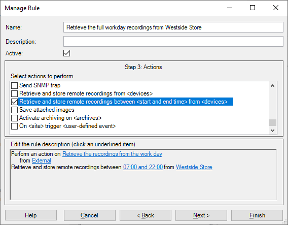

The setup of the rules is done in the XProtect Management Client using the ‘Manage Rulewizard.
A screenshot of a computer program

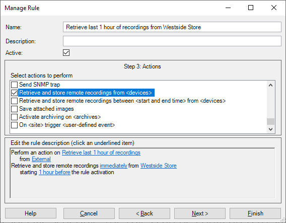

Description automatically generated
Rule example: Retrieve recordings from 7.00 to 22.00
Rule example: Retrieve last 1 hour
