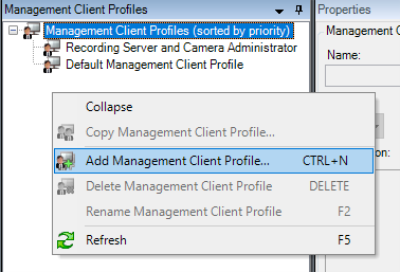

Create a Management Client Profile
To create a Management Client Profile:
  1. Right-click the ‘Mangement Client Profiles’ pane. and select‘ Add Management Client Profile‘.

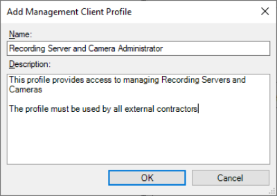

  2. Assign a name to it and, optionally, enter a description
By default, new profiles will provide access to all elements in the XProtect Management Client. To limit access to only some user interface elements, simply deselect the functions not needed.

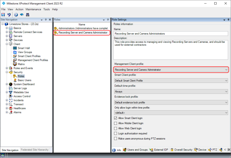

Having created a Management Client profile, the next step is to use it in a role:
  1. Create or select a role with management rights
  2. In the ‘Info‘ tab’s ‘Management Client profile:‘ dropdown, select the created profile.

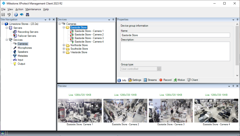

When users in this role log in with the XProtect Management Client, it will only show the user interface elements that have been enabled in the Management Client profile. All other elements are removed.
The screenshot below shows how the XProtect Management Client looks with only recording servers and devices enabled in the Management Client profile.

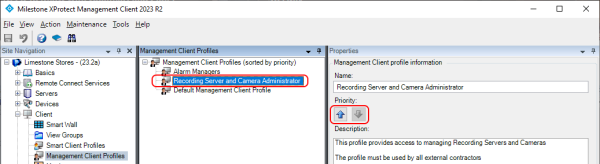

Multiple Management Client profiles
If the administrator logging in with the XProtect Management Client is a member of multiple roles configured with different Management Client profiles, the profile with the highest priority will be assigned.
The profile priority is set by changing the order of the Management Client profiles in the ‘Management Client Profiles’ pane. The profiles are listed with highest priority at the top, and lowest at the bottom. The priority can be changed by clicking the ‘Priority:’ up/down buttons.
