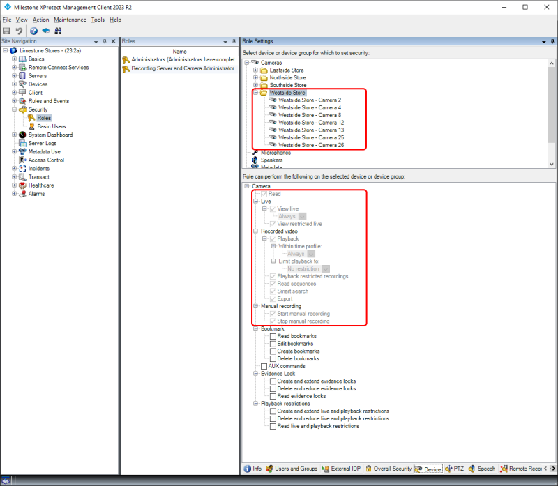

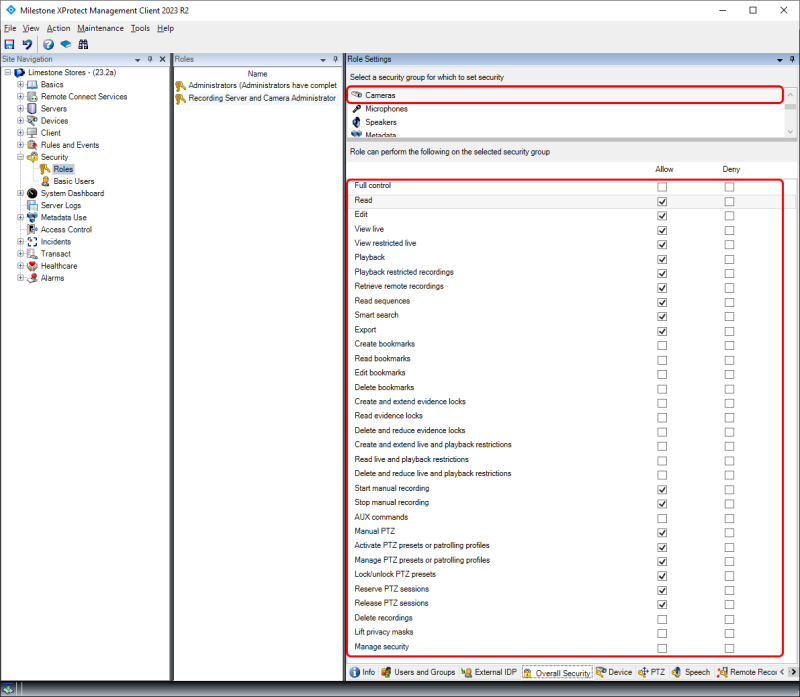

Allow permission
In the example below, permissions have been set to ‘Allow ’ for some of the camera functions.
Having set the camera permissions for the role in the ‘Overall Security ‘ tab. The ‘Allow ‘ permissions are now inherited by all cameras currently added to the VMS as well as cameras that may be added to the VMS later.
This can be seen by selecting the ‘Device’ tab, where the camera permissions set to ‘Allow ‘ on the ‘Overall Security ‘ tab, are now checked and greyed out for all cameras.

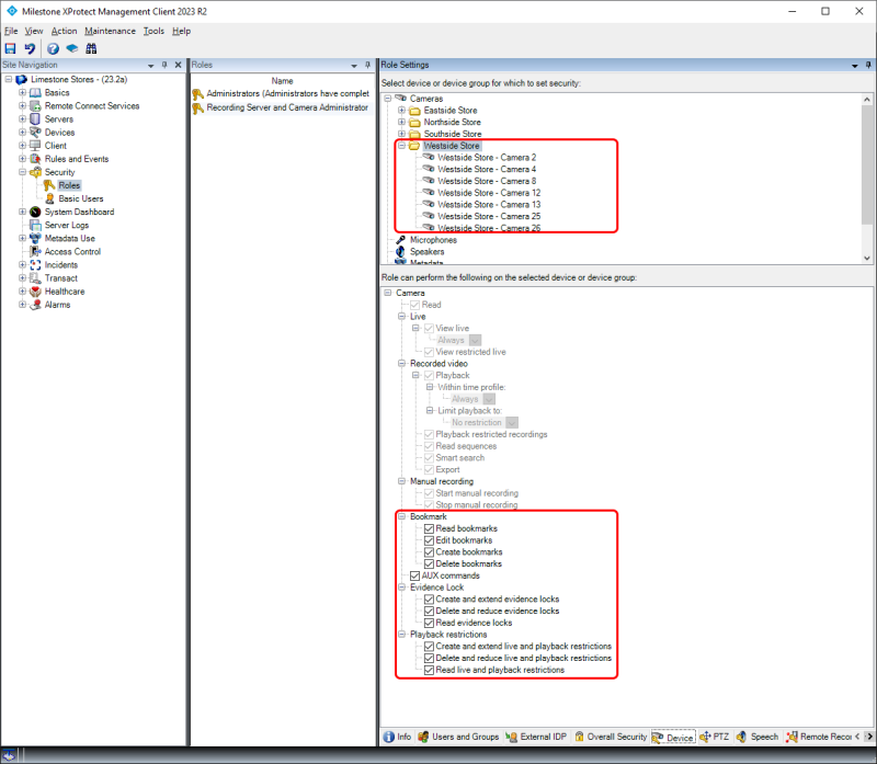

Settings not defined as either ‘Allow ‘ or ‘Deny ‘ on the ‘Overall Security ‘ tab can be set individually per group or per individual camera.

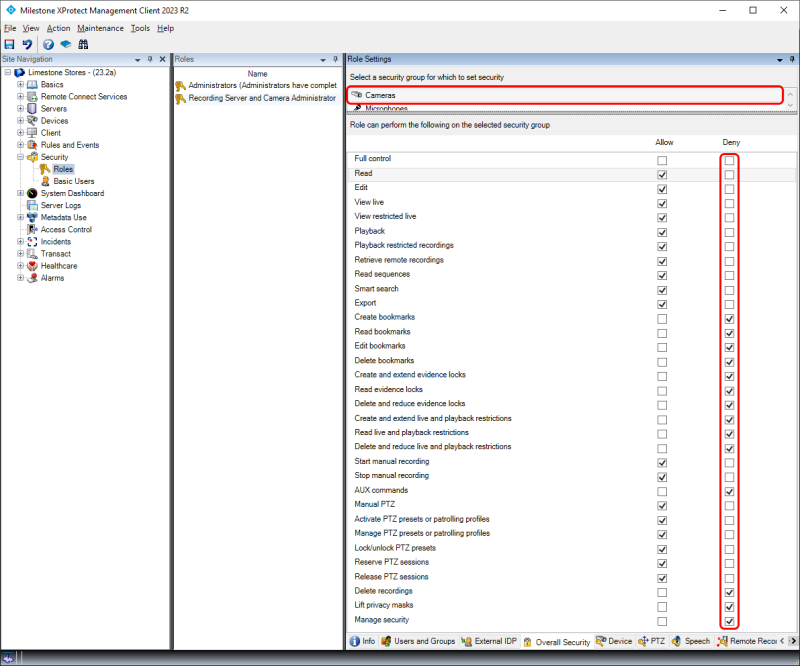

In addition to the ‘Allow ‘ permission, XProtect Corporate supports a ‘Deny ‘ permission. The ‘Deny ‘ permission can be used to override the ‘Allow ‘ permission in cases where users or administrators are members of multiple roles and, via the combined ‘Allow ‘ permissions in the roles, gain access to more functions than they should.

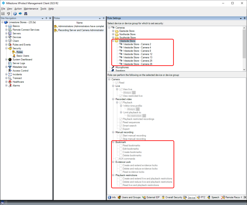

Therefore, by creating an extra role with ‘Deny ‘ set for the unwanted permissions and by adding the users or administrators to this role, the unwanted permissions can be removed for the users or administrators. This can be utilized to permanently or temporarily deny users or administrators access to functions and device types, that they would otherwise be able to access.
When selecting the device tab, the camera permissions set to ‘Deny ‘ on the ‘Overall Security ‘ tab, are displayed as unchecked and greyed out as they are inherited from the ‘Overall Security ‘ tab.
