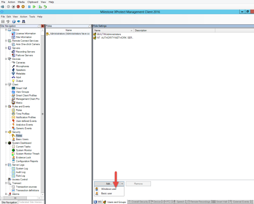

To add Windows users or groups to roles in Management Client, follow these steps:
- Open Management Client.
- Expand the Security node.
- Select the role to which you want to add the Windows users.
- On the Users and Groups tab, click Add, and select Windows user. A pop-up window appears.
- If the domain name does not appear in the From this location field, click Locations.
- Specify the Windows user, and then click OK.
To verify that the Windows user is an AD user, the domain name must appear as a prefix, for example "Domain\John".

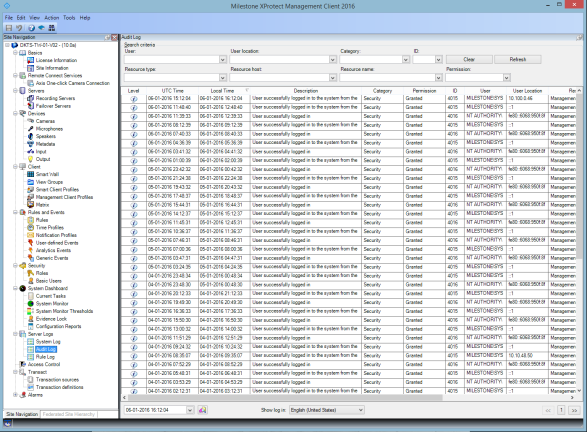

To turn on and configure extended user access logging, follow these steps:
- In Management Client, click Tools, and select Options.
- On the Server Logs tab, under Log settings, select Audit Log.
- Under Settings, select the Enable user access logging check box.
- Optional: To specify limitations for the information that is noted, and reduce impact on performance, make selections in the Playback sequence logging length and Records seen before logging fields.
To view the Audit Log in XProtect VMS, follow these steps:
- Expand the Server Logs node.
- Click Audit Log.
