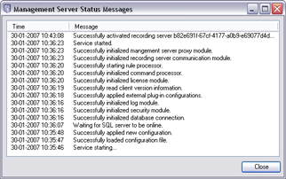

View status messages for Management Server or Recording Server
  1. In the notification area, right-click the relevant tray icon. A context-menu appears.
  2. Select Show Status Messages. Depending on the server type, either the Management Server Status Messages or Recording Server Status Messages window appears, listing time-stamped status messages:
    The status messages for servers shows individual messages and timestamps.
