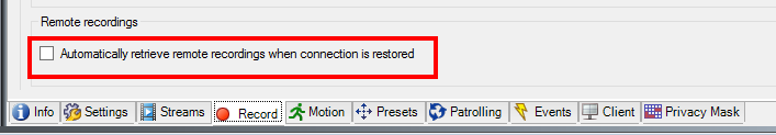

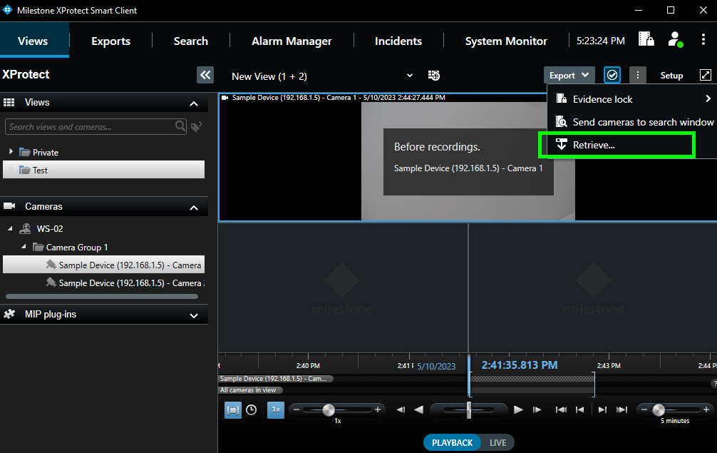

: Currently the ONVIF driver needs Media or Media2 service for Edge Storage support. And if Media2 service is available the ONVIF driver needs DeviceIO service. If these services are not available Edge Storage will not be supported.While the device is added in the Management Client, the driver will retrieve all services that the device supports. If all the mentioned services are implemented, the Edge Storage functionality will be available in XProtect. The automatic retrieving in Management Client will be available as well as the “Retrieve” button in the Smart Client.
Management Client
Smart Client
If one of these does not show in the Management Client or the Smart Client, then this means that Edge Storage is not available and therefore some of the important services are not implemented by the device firmware.
