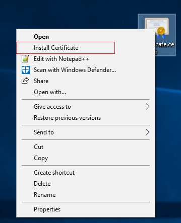

Copy the certificate to the Recording Server machine. Right Click on the Certificate and choose “Install Certificate”

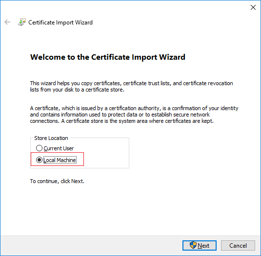

On the “Certificate Import Wizard” choose to install the certificate in the store of the “Local Machine”. Installation in this store is needed as the Recording Server runs under the user “NETWORK SERVICE” and can only access its user’s Certificate Store or the store of the Local Machine.

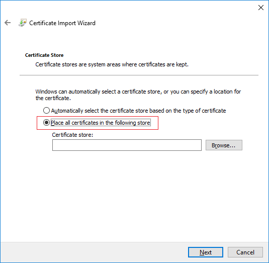

Choose to manually select the store in which the certificate will be installed.

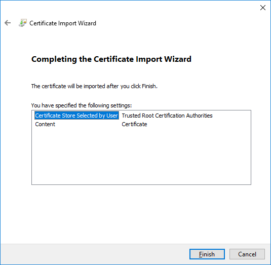

Click “Browse” button and select the “Trusted Root Certification Authorities”
Click Finish on the “Completing the Certificate Wizard” dialog.
You will receive a confirmation dialog of successful import.

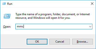

To verify that the certificate is imported start the Microsoft Management Console.

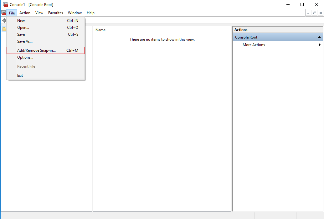

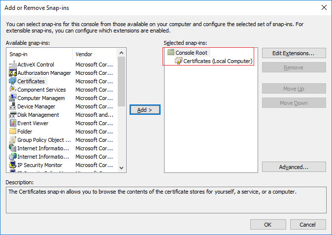

In the Microsoft Management Console from the File menu select “Add/Remove Snap-in…”

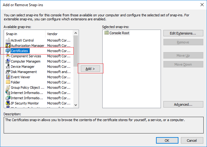

Select the “Certificates” snap-in and click the “Add” button.

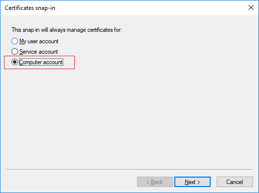

Select the snap-in to manage the certificate for the “Computer account”.

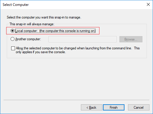

Select “Local computer” on the next step.
Click OK after the snap-in has been added.

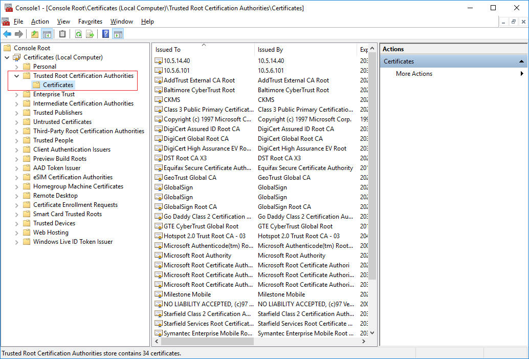

Verify that the certificate is listed in the center view of the “Trusted Root Certification Authorities” subtree.
