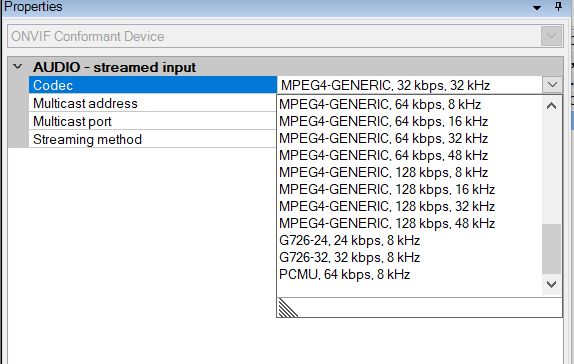

AUDIO IN |
Codec |
Combination of [Codec / Bitrate / Samplerate] Default value: The first configured from the dropdown list Supported codecs by the ONVIF driver are:
Dynamically taken from the device. In the list only valid combinations of codec, bitrate and sample rate will be visible. If a specific combination is supported by the device but not by the Driver/VMS it will not be listed. When starting the Driver/Recording Server if the device is currently set to an unsupported combination, it will be changed to one for the supported list (usually the first in the list). |
