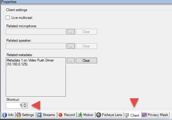

  1. In XProtect Management Client, select the camera, click the Client tab, and then make sure that a shortcut is defined in the Shortcut field.

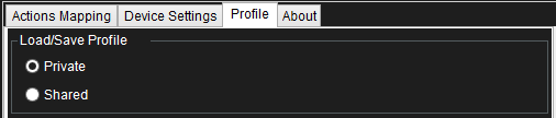

Profile settings

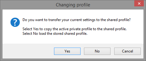

The current setting is stored privately on the server, but you can transfer it to the shared profile. The settings then apply to everyone who uses this profile.
A message displays if you change a profile. For example, changing a profile from Private to Shared.
