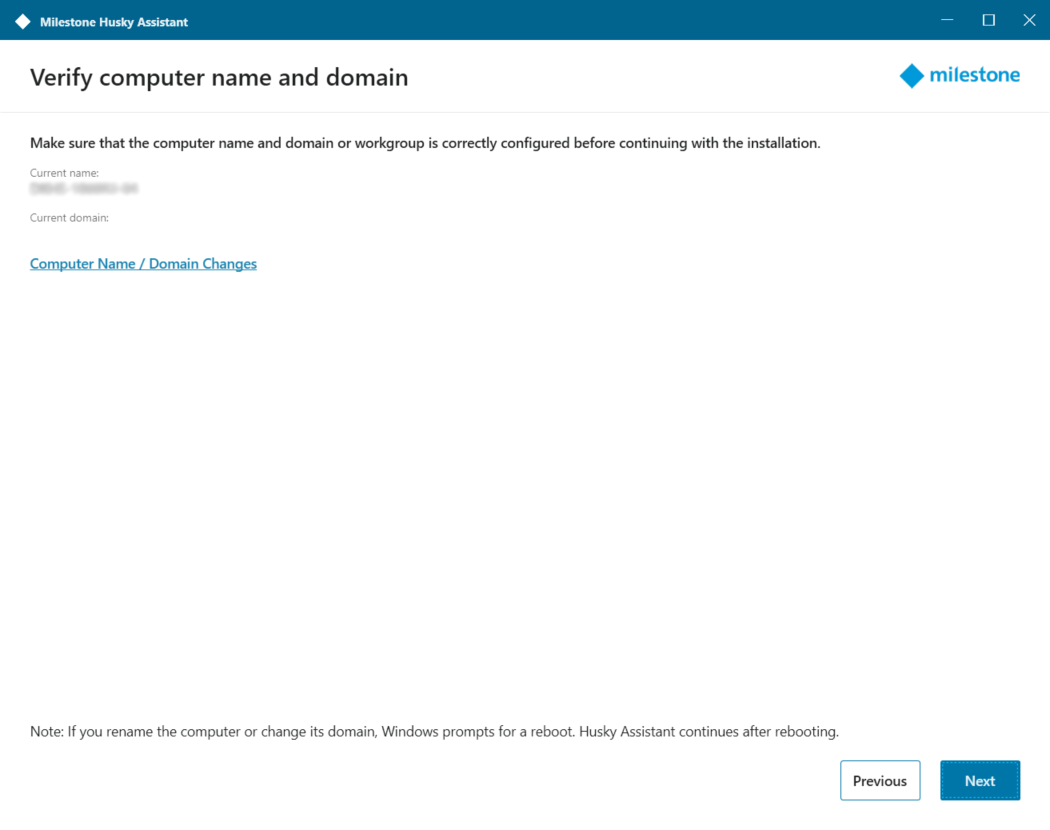

  2. Click Computer name / Domain changes to configure computer name and domain or workgroup settings.
    When completed, Windows will require a restart to apply the changes.
  3. Restart Windows and wait for Windows to boot.
    The Husky Assistant restarts. Click Next.
  4. Because you have already configured the name and domain setting, click Next.
