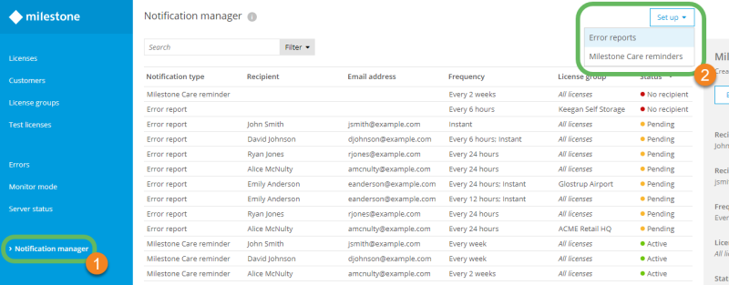

- Log in to Milestone Customer Dashboard (https://online.milestonesys.com/).
- In the main menu, select Notification manager
Select Set up > Error reports
Alternatively, select Set up error reports on the Errors page.

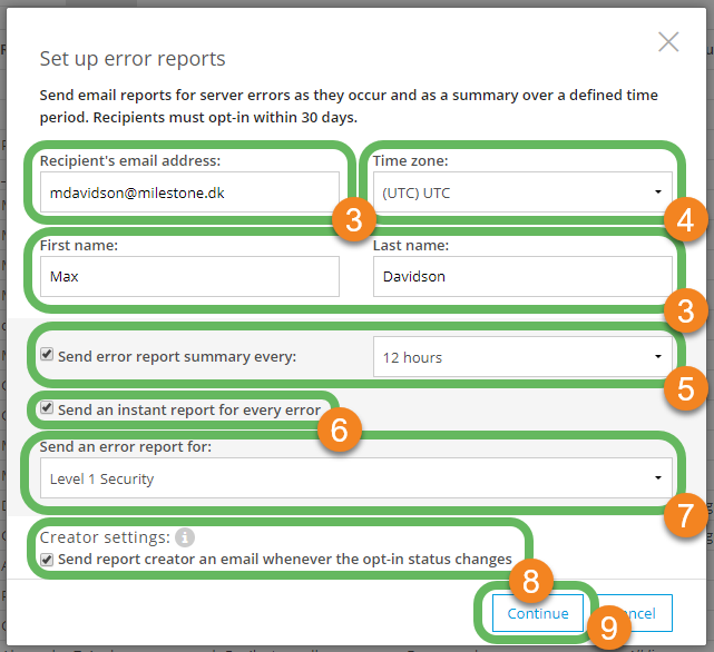

In the Set up error reports window, enter a valid email address, a first name, and a last name for the recipient.
Every time you change the Recipient's email address
, First name
, or Last name
, the recipient must subscribe to the error report again.
- Specify a Time zone
for the error report, usually the time zone where the recipient is located.
- To send a summary email of the errors that occurred over a specified time period, select the Send error report summary every check box and specify the time interval in the dropdown: 6 hours, 12 hours, or 24 hours
- To send an email alert for every error instantly as it occurs, select the Send an instant report for every error check box
Optional: In the Send an error report for
dropdown list, select a license group to specify which licenses you would like to include in the error report.
The default All licenses selection includes all of your current licenses and any future licenses that are added to your account.
Optional: Select the Send report creator an email whenever the opt-in status changes check box
to get notified about the opt-in status of the error reports. If the check box is selected, you receive an email every time the recipient subscribes, unsubscribes, or does not subscribe to the created error report profile within 30 days.
To meet GDPR requirements (gdpr-info.eu), recipients must subscribe to error reports within 30 days. If the recipient unsubscribes or does not subscribe within 30 days, the recipient information will be deleted and the error report profile will have a No recipient status.
Select Continue
to create the error report profile.
