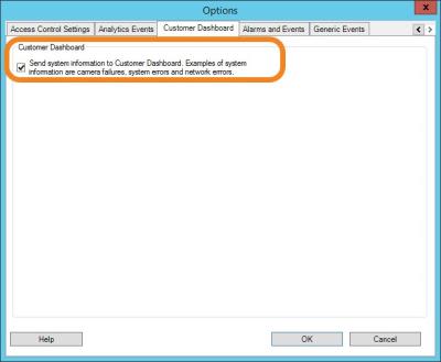

To send system information to Milestone Customer Dashboard, you must configure your VMS the following way:
- Open XProtect Management Client log in to the system.
Go to Tools -> Options, select the Customer Dashboard page, then select Send system information to Customer Dashboard. Click OK.
The XProtect VMS system will begin sending error information to Milestone Customer Dashboard. You can view the error information from the Errors page.
If the customer has a distributed system, each site must be configured separately.
