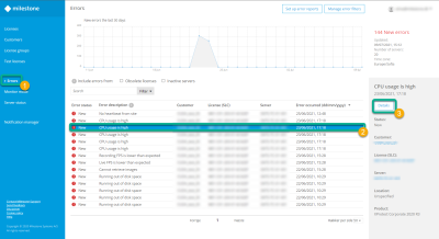

- Select the Errors page
. - Find the error that you want to see details about
For help locating errors, see Search for errors .
- Select the relevant error and click Details in the preview pane on the right-hand side
.To select the relevant error, you can also double-click the error row.

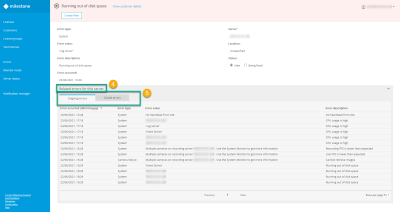

- On the error page, scroll down to Related errors for this server and click on the field to expand it
. - Click on Ongoing and Closed errors to see all server errors
